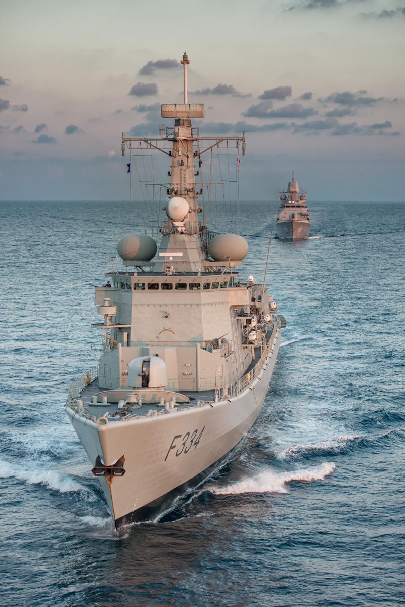

Re: Fragatas Classe Bartolomeu Dias
« Responder #745 em: Julho 22, 2015, 07:23:07 pm »
SNMG1- Black sea - RAS exercise with ROS Regele Ferdinand and NRP D. Francisco de Almeida - 16 JULY 2015 - Photo by WO ARTIGUES (HQ MARCOM)
SNMG1- Black sea - SNMG1- NRP D. Francisco de Almeida (F334) - 15 JULY 2015 - Photo by WO ARTIGUES (HQ MARCOM).
SNMG1- Black sea - SNMG1- NRP D. Francisco de Almeida (F334) and HNLMS TROMP (F803) in formation 1 - 15 JULY 2015 - Photo by WO ARTIGUES (HQ MARCOM).
